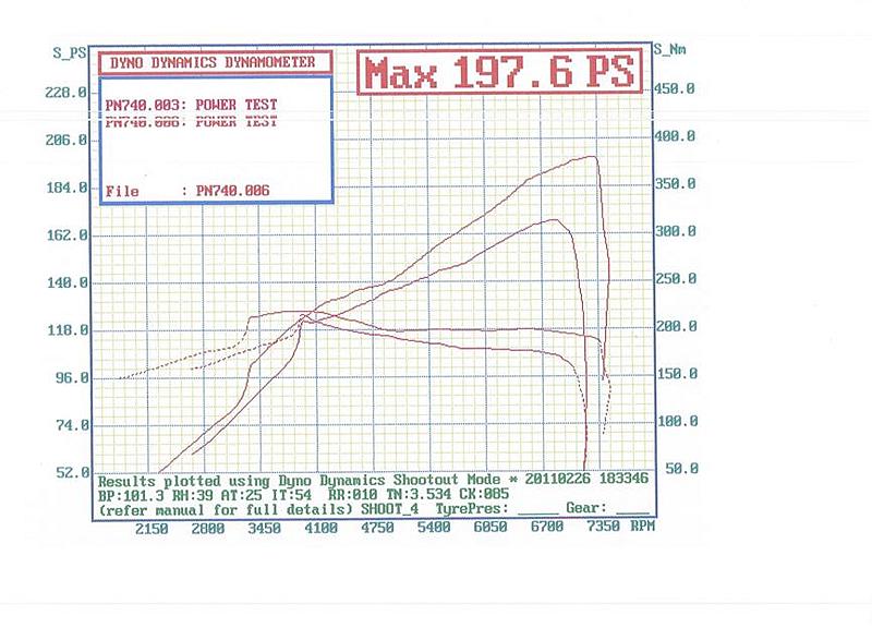

Max HP: 197.6 PS = 200.2 HP
Max Tq: 223 Nm = 165 lb/ft
Modifications:
M7 +2% crank
M7 -16% S/C pulley
M7 CAI
Forge TMIC
380cc injectors
Miltek header & full exhaust
GIAC tune
Nology wires, Denso plugs, MSD coil

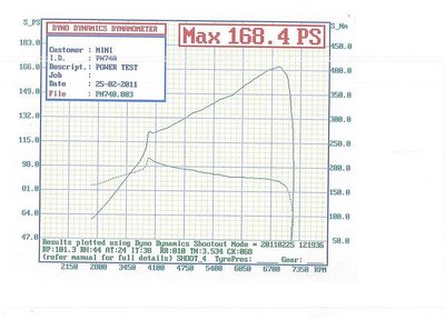

Adica-fulie arbore marita cu 2%,fulie compresor micsorata 16%,admisie rece,intercooler marit,INJECTOARE DE JCW DE 380cc,galerie evacuare custom,soft facut la GIAC Tune,fise, bujii,bobina inductie schimbate.Rezultat-200HP, costuri estimate de mine aprox. 2000Euro.
Aici diagramele :
stock: tunat hardware si software:
Aici diagramele :
