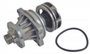

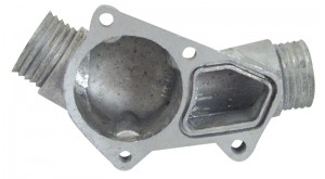

Upgrade Notice: Bavarian Autosport has an upgraded thermostat housing. The original housing is plastic and tends to crack. The upgraded part is cast aluminum.
Upgraded water pump that uses a metal impeller instead of the failure-prone plastic one. This part will eliminate the broken impeller problem once and for all.
*THERMOSTAT HOUSING WITH T
Part # : 11 53 7 647 751 $ 134.95

pt posesori de R56 CU MOTOR pejos N12,N14,N18......acest upgrade de corptermostat si pompa de apa este ffff bun ,ar mai trebui si teava de plastic dintre cele doua piese tot de metal :roll:
