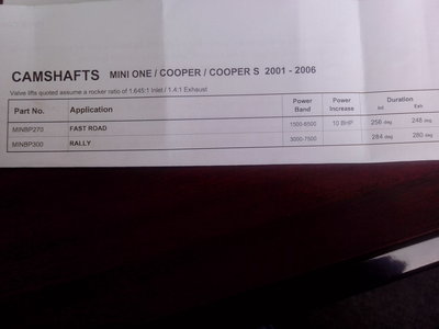

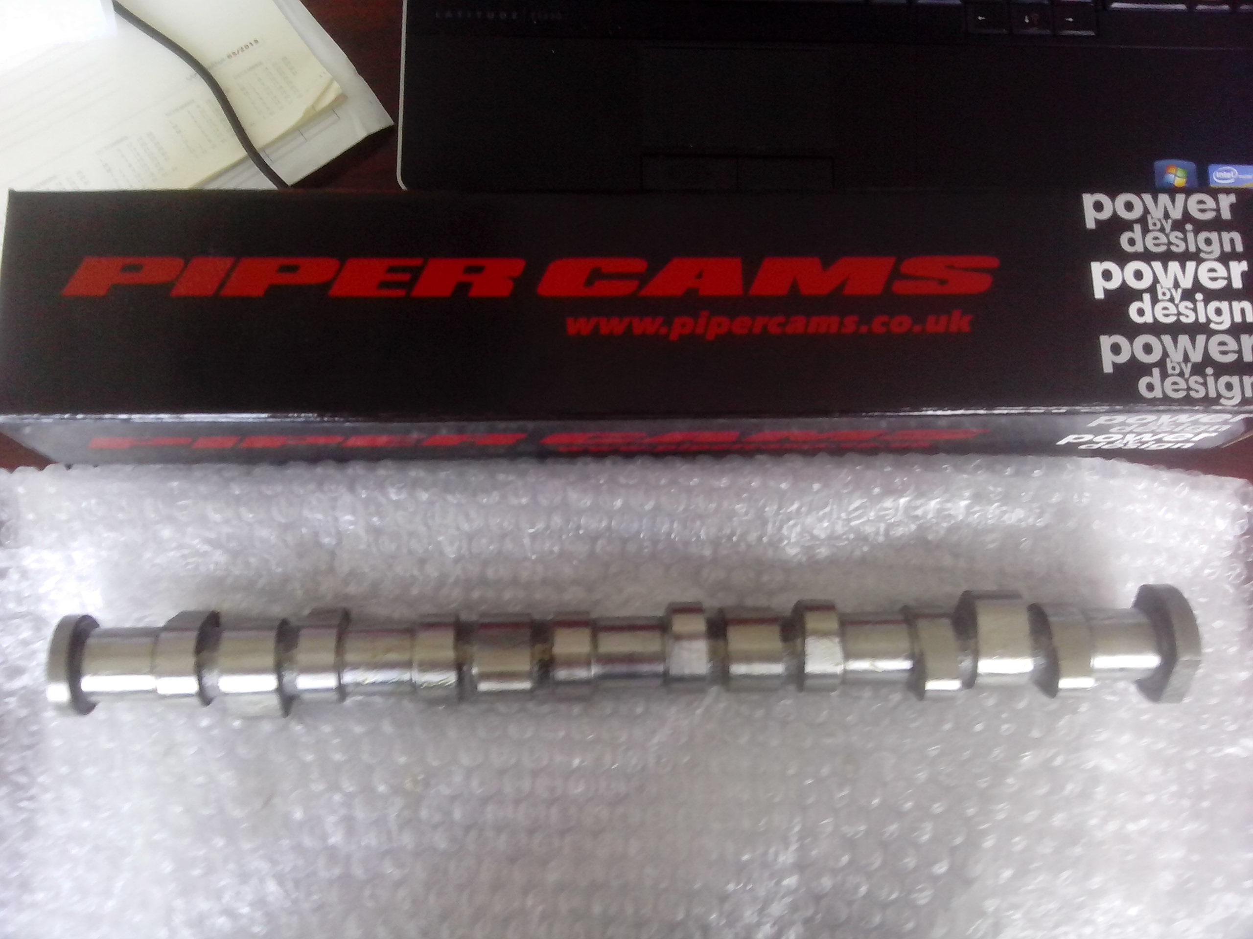

Sosit in sfarsit si ultima piesa,ax cu came de la Piper, model MINBP270 Fast Road.cateva specificatii:
Power band 1500-6500RPM
Power increase 10BHP
Duration 256deg Inlet ,248deg.exhaust.
