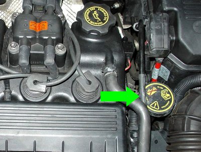

verifica asta:
The radiator cap that you can see in the photo was warped and not keeping the pressure in the system, and so a new one from Mini fixed the problem! About £14 if I remember correctly.
verifica daca nu pierzi presiune pe aici -> foto
