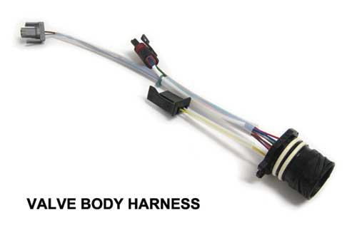

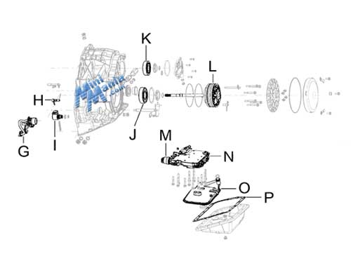

Item G - INTERNAL VALVE BODY HARNESS
Item H - PRIMARY PILOT TUBE
Item I - SECONDARY PRESURE SOLENOID
Item J - SECONDARY SUPPORT BEARING (SMALLER)
Item K - PRIMARY SUPPORT BEARING (LARGER)
Item L - PUMP ASSMEBLY
Item M - STEPPER SOLENOID - See NOTE below
Item N - VALVE BODY ASSEMBLY
Item O - PAN FILTER
Item P - OIL PAN GASKET

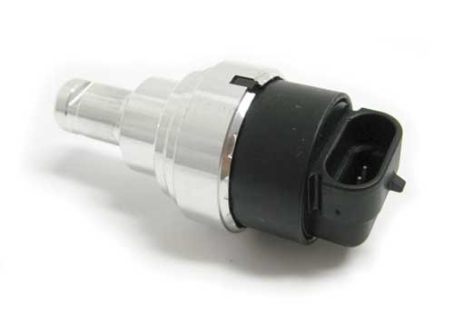

Note: Earlier Stepper Solenoids use a Twist-Lock type connector - these solenoids are no longer available. This replacement has a Snap Connector - not the Twist-Lock. There are no functional differences between the new style with the plastic cover and the old style aluminum version, but unfortunately due to the casting design on the early valve bodies, the new solenoid does not fit without some modification to the valve body. On early valve bodies, there is a protrusion on the valve body housing that prevents the solenoid from going all the way into the valve body. This protrusion, which has no functional use, can be safely removed from the aluminum valve body casting, allowing the new style stepper motor to fit fully into the valve body housing.
Item O - PAN FILTER
