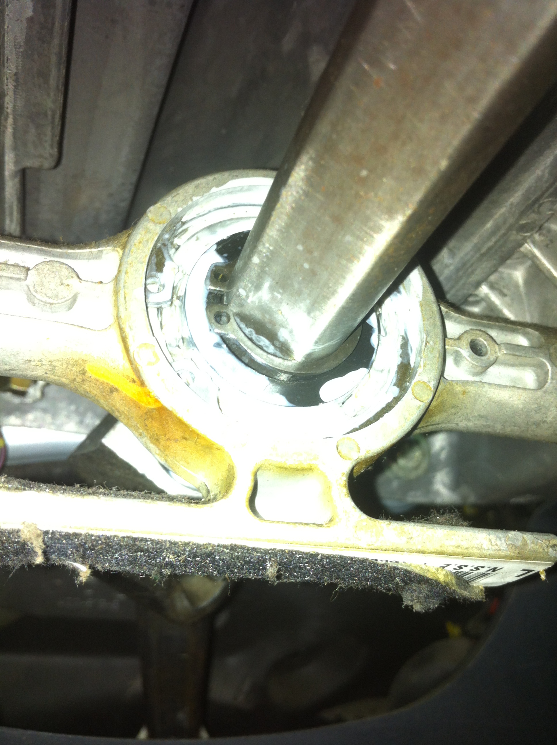

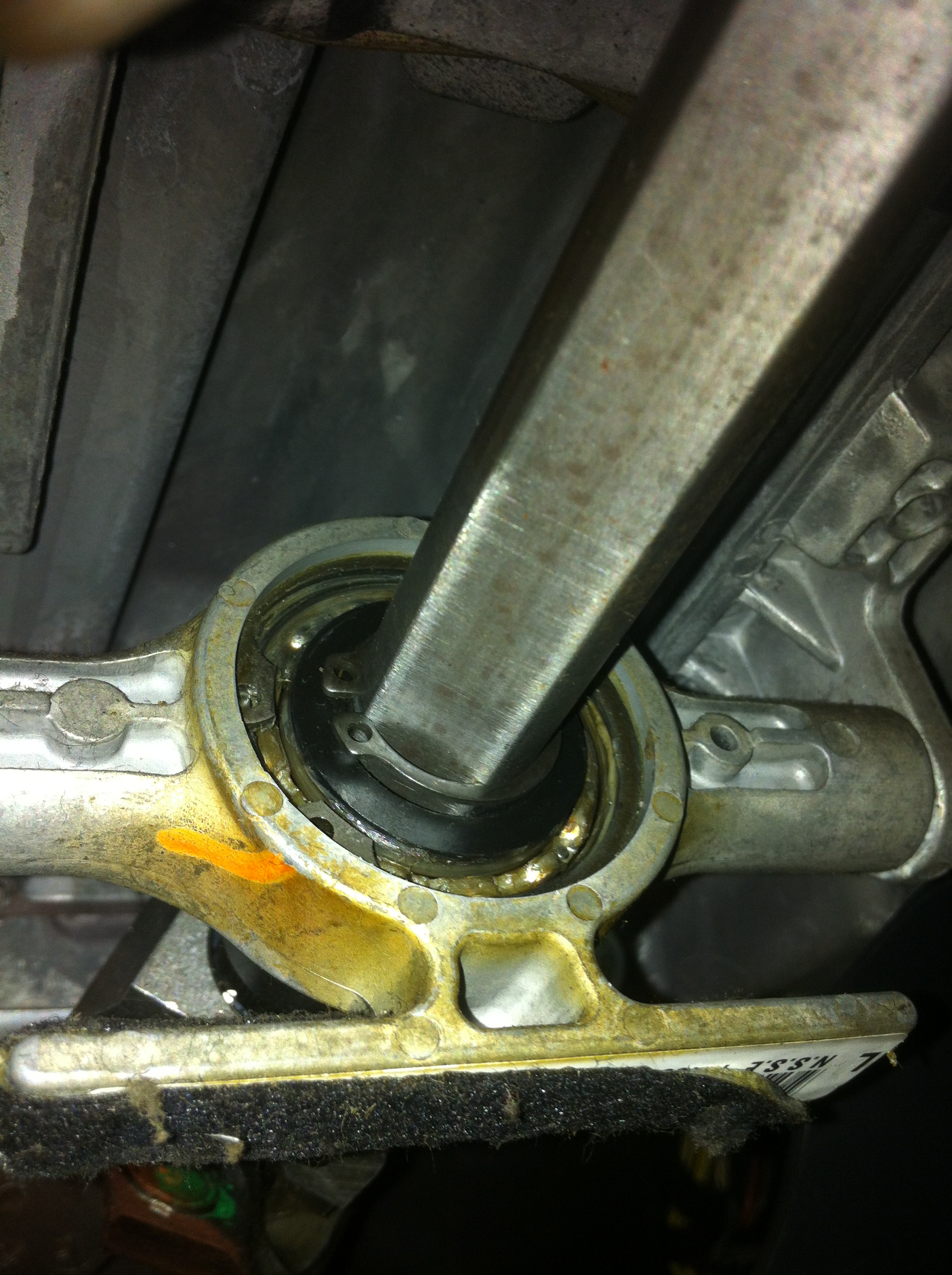

rezolvat si acest task
Utilizat: veselina cu litiu
after
after
before
before
